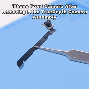

Starting from iPhone X, Apple introduced the TrueDepth camera system, which integrates several sensors responsible for Face ID, ambient light detection, and proximity functions.
Because these components are serially paired to the logic board, replacing the entire assembly will permanently disable Face ID.
However, if only the front camera module (not the Dot Projector or IR Camera) is damaged, it can be replaced without losing Face ID — provided the original TrueDepth sensors remain intact and untouched.

To replace only the front camera module within the TrueDepth assembly:
- Retain the original Dot Projector and IR Camera — they are paired to the logic board.

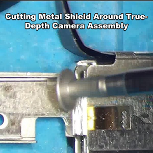

- Cut open the metal cage around the front camera.
- Remove and replace the front camera module only.
- Reassemble carefully, ensuring no damage to the Dot Projector or IR Camera.
When done properly, Face ID will continue to function normally, and the new camera will work for photo/video.

- Expose the Front Camera
- Locate the metal shield covering the front camera on the TrueDepth module.
- Use a mini-dremel or precision cutter to carefully slice open the metal shield — do not apply heat directly to avoid sensor damage.
- Remove the Damaged Camera
- Heat the camera slightly and lift out the front camera module using tweezers.
