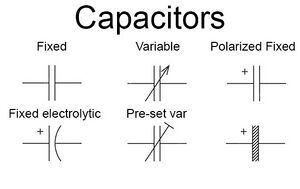

Capacitors in schematics look like in Figure 1 and are usually denoted with the letter C followed by an identifier number. (E.g. C211)

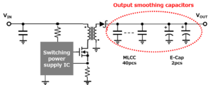

Capacitors are used at the input/output stage of DC-DC voltage converters. DC-DC converters inherently produce pulsating or "ripple" DC output voltage due to the switching action of electronic components. Capacitors are employed to filter and smooth this output by storing and releasing electrical energy, reducing voltage fluctuations and ensuring a more stable DC voltage as shown in Figure 3

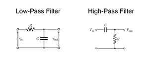

Frequency filtering (low/high pass)
Capacitors, characterized by their high resistance to direct current (DC), effectively block DC passage. In contrast, with high-frequency alternating current (AC), capacitors cyclically charge and discharge in response to the changing current polarity. This dynamic behavior creates the impression that AC flows through the capacitor, akin to its behavior as a conductor.
![](/images/thumb/8/8e/Capacitor_filters.jpg/300px-Capacitor_filters.jpg)
The most basic filtering circuits are Low-pass and High-pass filters (Figure 4), they -as the name suggests- either let low or high frequency signals pass though them.
