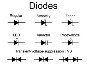

Diode symbols commonly found in schematics (Figure 1)
What is a Diode?
A diode is a fundamental semiconductor device commonly found in electronic circuits. A diode has two terminals called Anode and Cathode, and its primary function is to allow the flow of electric current in one direction while blocking it in the opposite direction. This property makes diodes useful for rectifying alternating current (AC) into direct current (DC), protecting circuits from reverse voltage, and more.
Diodes have different characteristics found in their datasheets, the most important value when measuring is the forward voltage drop in "Volts".
Diodes are typically identified by the symbols shown in Figure 1 and are usually denoted with the letter D followed by an identifier number. (E.g., D38)
