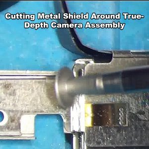

Example image (Figure 1) -- Cutting Metal Shield Around Front Camera

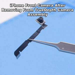

  1. Retain the original Dot Projector and IR Camera — they are paired to the logic board.
  2. Cut open the metal cage around the front camera.
  3. Remove and replace the front camera module only.
  4. Reassemble carefully, ensuring no damage to the Dot Projector or IR Camera.

Example (Figure 2) -- iPhone 11 Pro Camera After Removing From TrueDepth Camera Assembly

  2. Expose the Front Camera
    • Locate the metal shield covering the front camera on the TrueDepth module.
    • Use a mini-dremel or precision cutter to carefully slice open the metal shield — do not apply heat directly to avoid sensor damage.
  3. Remove the Damaged Camera
    • Heat the camera slightly and lift out the front camera module using tweezers.
