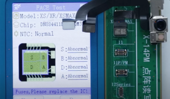

In this guide we will use the "JC" tools to diagnose and fix this issue, you can use JC V1S, JC V1SE, JC V1S Pro, the process is the same in all devices.
The first step is to remove the dot projector from the phone and connect it to the machine and click on read, the machine will test the component and tell you if it's faulty like this.
Dot Projector Test Fail
