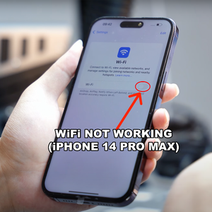

iPhone WiFi not working - 14 Pro Max (fig. 1)
  • Wi-Fi toggle is greyed out (see fig. 1)
  • Wi-Fi address shows "N/A" in Settings -> About
  • Bluetooth toggle spins endlessly and never enables

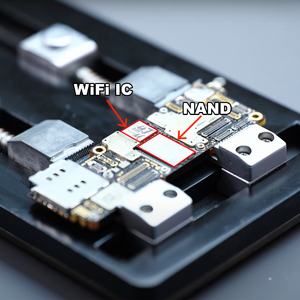

    WiFi IC and NAND - iPhone 14 Pro Max (fig. 2)
Repair Steps
(We used an iPhone 14 Pro Max as an example)
  • Locate and remove faulty WiFi IC (see fig. 2)
  • Locate and remove the NAND (see fig. 2)

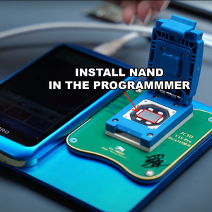

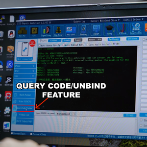

  • Place the NAND in the JC programmer and run Query Code / Unbind (see fig. 3 & 4)
    NAND installed in JC V1SPRO Programmer (fig. 3)
    Query code/unbind on JC Programmer (fig. 4)

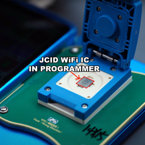

  • Power up the phone and connect it to the JC programmer (On models where the WiFi ic is on the lower board, you will need to power it up in an iSocket)

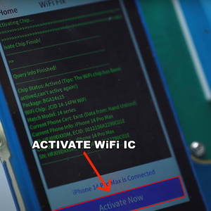

  • Install a new programmable Wi-Fi IC in the programmer and run Activate Wi-Fi IC (see fig. 5 & 6)
    JCID WiFi IC installed in V1SPRO programmer (fig. 5)
    Activate WiFi IC (fig. 6)
  • Once activation is successful, reball the new IC and re-install it on the logic board (see fig. 7)

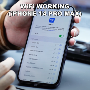

  • Power up the iPhone and verify that Wi-Fi functions are restored (see fig. 8)
    iPhone WiFi functional after WiFi IC replacement (fig. 8)
