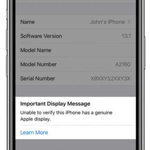

When performing a display replacement on iPhone models that require Touch IC transfer (e.g. iPhone 12-16 series), even after transferring the original touch IC from the old display to the new one, the “Unable to verify this iPhone has a genuine Apple display” message still shows up.
This usually occurs due to MTSN data mismatch — the new display doesn’t have the correct pairing data that tells the phone it’s the original display.
Symptoms
  • “Important Display Message” still shows after successful touch IC transfer.
  • Everything else (touch, brightness, Face ID) may work fine.
    "Important Display Message"

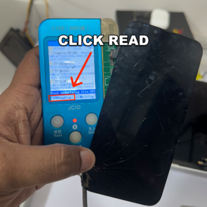

  1. Read Old Display MTSN Data:

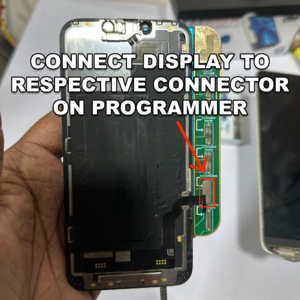

    • Before transferring touch IC, connect old display to JC V1SE/V1SPRO programmer.
      Connect Display to Appropriate Connector
    • Select Read MTSN or Read Display Data and save to PC/programmer.
      Read

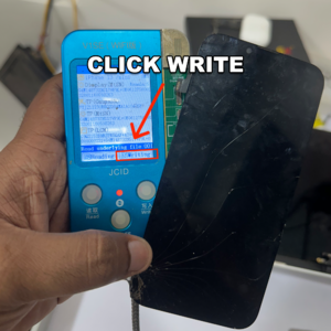

  2. Write to New Display:
    • Connect new display to programmer.
    • Select Write MTSN or Write Display Data to program old display’s data to the new one.
      WRITE

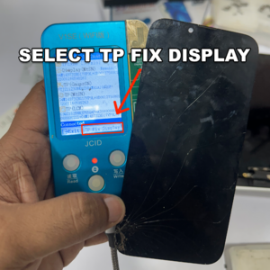

Method 2: Post-Transfer Fix (If Already Transferred Touch IC)
  1. Connect Phone to Programmer:
    • After touch IC transfer, connect phone with new display installed to JC Programmer.

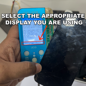

  2. Use Fix True Tone Option:
    • On JC Programmer, select Fix True Tone.
      TP Fix
    • Select the appropriate display you are using, original or third party.
      Select Display

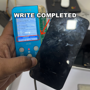

    • This will rewrite correct MTSN data to the new display flex.
      Verified correct data written to new display
  3. Reboot Phone:
    • Power cycle device → confirm that “Important Display Message” is cleared.
