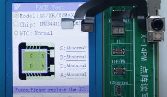

The dot projector is located right next to the front camera.
iPhone Face ID Components Location
In this guide we will use the "JC" tools to diagnose and fix this issue, you can use JC V1S, JC V1SE, JC V1S Pro, the process is the same in all devices.
The first step is to remove the dot projector from the phone and connect it to the machine and click on read, the machine will test the component and tell you if it's faulty like this.
Dot Projector Test Fail

In this guide we will be using the "Tag-On" method.
Install JC repair software on a computer, and open the program.
Connect your iPhone without the dot projector to the computer and turn it on and authorize USB data transfer.
Connect the programmer that you are using to the computer and go to the repair fitting section and click on connect.
With the dot projector connected to the programmer, click on "Activate Repair", a small pop-up window will appear, click on activation.
Note: There are two types of boards for these programmers, one that has a USB-C port on top and one that has two big caps, if you have the version with the USB-C port you must connect it to a fast charging power brick.
JC face ID boards
After clicking on activation wait until the window shows up "Activation Complete!"
Activation Complete
After "Activation Complete!" success you can disconnect the dot projector from the programmer, and connect your flex, on the JC repair program click on Detect, and it showed, detect the flex.
Next click on Write From AI, a small pop-up window will show up, select your device and click on "OK", and it will write the information to the flex.
After writing the information to the flex you can disconnect the flex from the programmer and the iPhone from the computer.
