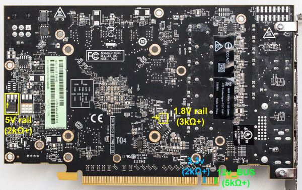

Before doing anything, it's a good idea to inspect the card for physical damage. Especially cards that have no backplate. They can easily lose some components on the back due to poor handling.
After making sure there is no physical damage to the card itself you can now move on with a multimeter to check the resistances of the voltage rails.

Start by measuring the resistances of the 12V rail coming from the PCIe slot (first 3 pins, see figure 1).
After that, measure each inductor for external power connectors (some cards have multiple external power connector and each of them have their own inductor you have to measure each of them individually).
The resistance varies from card to card and the value itself doesn't matter but it should be in the thousands+ Ω range.

The card gets 3.3V from the PCIe slot only, from the 4th pin going left from the PCIe key notch in the front, and 2nd and 3rd pins on the back going from the notch again. (Figure 1 and 2)
If you get less than 50Ω on one or multiple base rails then you have a card with a short. The computer might not turn on in such a case because the power supply is protecting itself using OCP (over current protection). Repair Guide: Base Voltage Rail Short on Polaris GPUs
*On MSI RX cards, the 3.3v pin has a resistance to ground of about 200 ohms.
Otherwise, if you have no short then you can continue troubleshooting.

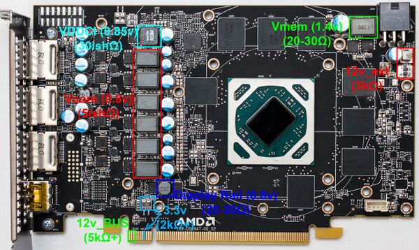

Step 2: Minor Voltage rails. (5V, 1.8V, Display Rail, VMem, VCore, and VDDCI)[edit | edit source]
Minor voltage rails are the ones created by the card itself using the base rails through either Linear Voltage Regulators or Step Down Buck Converter
Check the resistance of the output of those rails and compare them with Figure 1 and 2. VCore has such a low resistance that you won't find it useful to measure its resistance. A more helpful way is to measure its resistance against the 12v rails not GND.
If you get lower resistance on one or more of those rails, head to their pages linked below.
Otherwise, continue with the guide.

The order in which they turn on in most polaris GPUs is as follows:
5V→ 1.8V→ Display Rail → VMem/VDDCI → VCore. (In some cases, VDDCI turns on after VMem, while in other cases VDDCI and Vcore are controlled by the same controller and they turn on at the same time)
For example, if 5v does not turn on, everything else in the chain won't turn on either. Hence no fan spin if you have a problem with 5V or 1.8V.
