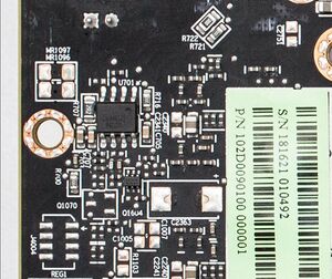

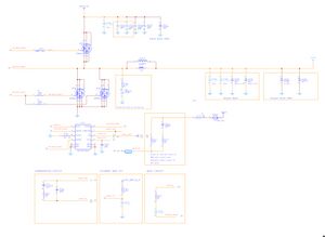

VMem refers to the voltage supplied to the memory chips on the graphics card. The controller for VMem is often the GS7256. In some cases, the UP1666Q is used (found in certain Gigabyte models). This page will focus on the GS7256, which is the most common variant.
The VCC supply for the controller can vary depending on the model, with some receiving it from the 5V rail, while others utilize the 12V_EXT rail, as shown in the schematic.

Location of Vmem on the RX 480 Reference board (Figure 1)
Schematic of the Vmem controller (Figure 2)

Initiate your troubleshooting process by measuring the EN and VCC pins of the controller. If either of these pins is missing or shorted, the controller will not function. If both pins show as high, proceed to examine the FB circuit, as illustrated in Figure 2.
If everything appears to be in order, yet VMem remains absent, it could be indicative of a malfunctioning MOSFET. MOSFETs often exhibit short circuits when they fail, but at times, they can cease functioning without shorting. You can verify this with an oscilloscope by measuring the gate of the MOSFET or the "UGATE" pin of the controller to confirm whether the controller is generating the PWM signal. If no signal is present, the controller is likely dead.
