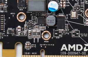

Often referred to as the 0.8V rail, the Display Rail is typically controlled by either the GS9238 or the APW8713 step-down voltage converters. These controllers take 3.3V (or in some cases 12V_BUS) and convert it to 0.8V. Sapphire cards, on the other hand, may use an MPS NB671 for the Display Rail buck converter, which has a slightly different pinout.
Location of the 0.8V controller on an RX 480 Reference card (Figure 1)

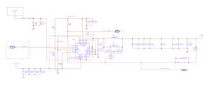

Schematic view of the 0.8V controller (GS9238 version) (Figure 2)

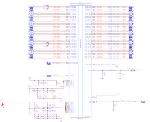

Enable signal schematic for the 0.8V regulator (Figure 3)
While the markings on the schematic and board may vary between GPU models, the circuit design is typically consistent.
It's important to note that the GS9238 generates its own 5V on the VCC pin and does not require external power, except for Vin. In contrast, the APW8713 needs external 5V on its VCC pin to operate, which it receives from the 5V Rail on Polaris GPUs.
The Enable signal comes from the POK pin of the 1.8V Rail on Polaris GPUs, which is the gate of an NPN transistor, shorting the EN signal to GND, as depicted in Figure 3.

If Vin is also confirmed to be present, verify that the feedback resistors have the correct values as shown in Figure 2.
