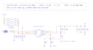

Polaris cards typically use a GS7103-A or a similar Low Drop Out (LDO) regulator to control the 1.8V rail.
The output voltage is adjusted through the FB pin using a voltage divider (please refer to the datasheet or Figure 2).

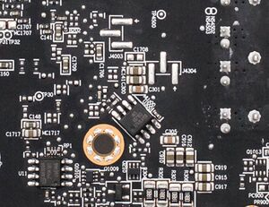

Location of the 1.8V regulator on an RX 480 Reference card (Figure 1)
Schematic view of the 1.8V regulator (Figure 2)

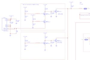

Enable for 1.8V regulator schematic view (Figure 3)

Begin by checking the EN (Figure 3) and VCC pins. If either of them is missing, the controller will not operate. The enable pin should always be in a high state as soon as the card receives power, while VCC is supplied from the 5V LDO, either directly or through a low-resistance path.

If all of the above checks out but there is still no output, investigate the voltage divider on the FB pin according to the schematic (Figure 2) or the datasheet.
