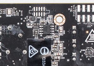

The creation of the VDDCI voltage rail depends on the VCore PWM controller used. In some instances, VDDCI is generated by the same VCore controller, such as the NCP81022 or UP9505P. Alternatively, a dedicated regulator like the GS7250 or a similar buck converter is used.

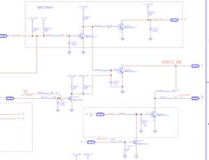

The PGOOD signal for VDDCI is generally not used for any specific purpose. VCC is supplied either from the 5V rail or from the 12V rail through a resistor. The Enable signal is sourced from the POK (Power OK) signal from the Display Rail controller. This POK signal switches an NPN transistor, which, in turn, switches another NPN transistor that is holding the enable signal low, as illustrated in Figure 3.
Location of the VDDCI buck converter on an RX 480 Reference board (Figure 1)

VDDCI enable signal schematic (Figure 3)
Please note that while markings on the schematic and board may vary among GPU models, the fundamental circuit design remains largely consistent.

Initiate your troubleshooting process by measuring the EN and VCC pins of the controller. If either of these pins is low or shorted, the controller will not operate. If both pins are in high state, proceed to examine the FB circuit, as illustrated in Figure 2.
