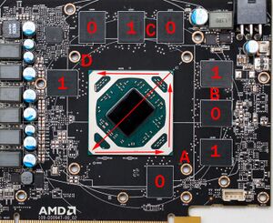

Memory Channel Labeling
before we start, it is important to understand how memory is labeled on AMD graphics cards. Each 2 memory chips form a memory channel, starting with the letter A and continuing alphabetically until the last channel. Below is memory labeling on Polaris cards:
Memory channel labeling on Polaris cards. (Figure 1)
Vertical artifacts labeling on Polaris cards. (Figure 2)
Unlike Nvidia cards, Memory channels start with chip 0 then chip 1 instead of chip 1 and chip 0.

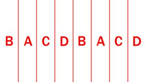

Sometimes when a memory chip is faulty, the card still outputs a picture but with vertical lines on the screen. It is possible to identify which channel is faulty from the position of the vertical lines as shown in figure 2. This does not mean that both memory chips are faulty.
