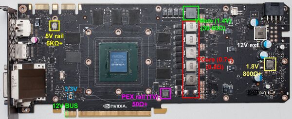

The Card Layout
Before proceeding, it's crucial to visually inspect the card for physical damage, particularly cards without a backplate, which can be more vulnerable to component loss due to mishandling.
Once you've confirmed there's no physical damage to the card, you can proceed with using a multimeter to check the resistances of the voltage rails.
Step 1: Base Voltage Rails (12V, 3.3V)
Base voltages are supplied to the card through the motherboard and external 8-pin power connector(s). Here is a page with further details: What are the Base Voltage rails for GPUs?
12V rails
The card receives 12V power through the PCIe slot and additional 6-8-pin connectors. Start by measuring the resistances of the 12V rail coming from the PCIe slot (first 3 pins, see Figure 1).
Next, measure the resistance of each inductor for external power connectors (some cards have multiple external power connectors, and each of them has its inductor).
The resistance values can vary among different cards, but they should generally be in the thousands of ohms or higher. A resistance reading of 50 ohms or less indicates a short circuit on the card causing the computer not to power on due to overcurrent protection (OCP) by the power supply.
Solution: Check out this page dedicated to Base Voltage Rail Short on Pascal GPUs.
3.3V rail
The card receives 3.3V power exclusively from the PCIe slot. You can find the pins in the front (4th pin going left from the PCIe key notch) and on the back (2nd and 3rd pins going from the notch again).
If you measure less than 50 ohms on one or more base rails, it signifies a short circuit on the card, potentially causing the computer not to power on due to overcurrent protection (OCP) by the power supply.
If no shorts are measured, you can proceed with troubleshooting.
Step 2: Minor Voltage rails. (5V, 1.8V, VCore, VMem, and PEX)
Minor voltage rails are created by the card itself using the base rails through either Linear Voltage Regulators or Step-Down Buck Converters.
Check the resistance of the output of these minor rails and compare them with Figure 1.
The VCore rail often has very low resistance on 1000+ series cards, making it unhelpful to measure its resistance directly. Instead, measure its resistance against the 12V rails (not GND).
If you identify lower resistance on any of these rails, refer to their respective pages linked below. Otherwise, continue with the guide.

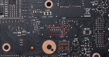

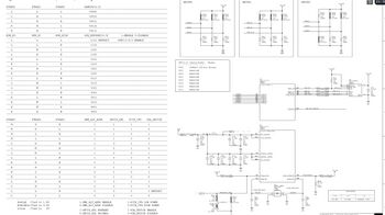

Straps
Straps can be understood as physical settings for the card. Depending on which series of strap resistors are populated, they instruct the card on various configuration parameters. For example, they can indicate whether the installed memory is from Samsung or Micron.
Assuming there's no physical damage to the strap resistors, check their resistance values outside the circuit. Sometimes, although rarely, these values may change. Refer to the strap locations (Figure 2) and their schematic (Figure 3).
