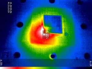

If you have access to a thermal camera, it is extremely easy to tell if the core is the source of your short. On Nvidia GPUs, the "1.8V" portion of the GPU is typically in the bottom left corner, and as a result shorts on the 1.8V rail often look similar to the images below.
A GP102 die where the die is the source of a 1.8V short
A GP104 die where the die itself is the source of a short on the 1.8V rail
