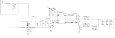

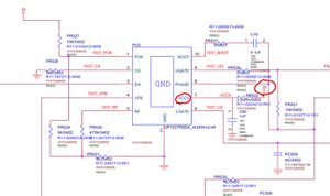

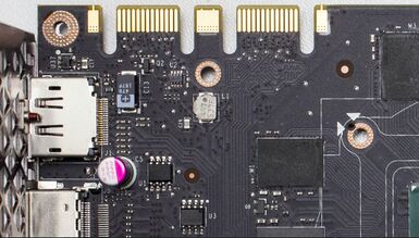

For reference, the location of the 5V rail on the board is illustrated in Figure 1, and the schematic for the 5V rail is provided in Figure 2.
It's worth noting that many GPU boards lack component markings, and when present, these markings may not always match the schematic. However, the underlying circuit remains consistent. For instance, U2 in Figure 1 corresponds to U27 on the schematic.
The 5V rail is a relatively straightforward rail and is typically the first to activate. The controller is enabled by the 3.3V rail through a 1kohm resistor, and capacitors serve to stabilize the voltage.
Most controllers require 5V on the VCC pin for operation. Notably, the RT7296F generates its own 5V supply for the VCC pin, drawing power from 12V_BUS along with some capacitors on the Vin pin.
The controller's primary function is to regulate the 12V input voltage down to 5V on the output. This regulation is achieved through a resistive divider connected to the FB pin (as shown in Figure 2).
Finally, if the power output remains within 90% of the expected voltage, the PG (Power Good) pin will transition to a high state. In most Pascal GPUs, the PG pin on the 5V controller is linked to the EN pin on the 1.8V controller via 0ohm resistor.

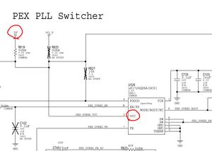

The 5V rail is most commonly used to power the VCC pins for other ICs on the board. Below are examples for 5V powering on the PEX and Vmem ICs.

First thing to check is the EN signal which should be 2+V followed by Vin which should be 12V (Figure 2) if one of them is missing then check the schematic and follow the signal to find the culprit, it's usually a faulty resistor.
After making sure both of the above are there, check the VCC pin. If there is no 5V on it then most likely the controller is faulty and needs changing. If there is 5V on VCC, check out the resistor divider and make sure their values are the same as in the schematic (Figure 2).
