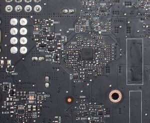

Location of the PWM controller on the back of the board. (Figure 1)

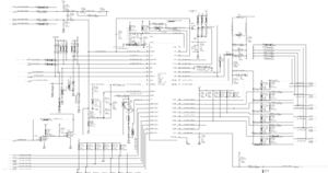

Schematic view of the PWM controller. (Figure 2)

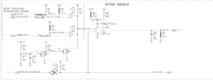

Enable signal schematic for Vcore in Pascal GPUs. (Figure 3)
Nvidia uses the UP9511p, manufactured by UPI Semi, as the PWM controller in most of its high-end Pascal graphics cards. However, in certain cases, like the hybrid version of EVGA cards, they opt for the NCP81274 instead.
While the specific markings on the schematic and board may vary between GPU models, the core circuitry remains quite consistent.
To power up the controller, a 2.2-ohm resistor on pin 12 connects it to the 5V rail.
Enabling the controller relies on the PG signal from the 1.8V controller, combined with a protection circuit signal, processed through an AND gate as depicted in figure 3.
The PG signal emanating from this controller enables the VMem controller.

The PWM signals generated by the UP9511p controls the voltage going to power the GPU core. Switching 12V to 0.7-1V depending on the load on the GPU.
Depending on the model and manufacturer of the board and the components used, the PWM signals either go to the VRM directly, driver IC, or a doubler IC.
