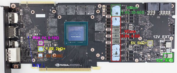

The Card Layout
RTX 2080 Reference board layout. (Figure 1) *PCB Image courtesy of TechPowerUp*

Step 1: Base Voltage Rails (12V, 3.3V)
What are the Base Voltage rails for GPUs? The base voltages are the ones that get supplied to the card through the motherboard and the external 8pin power connector(s).
12V rails
Graphics cards derive 12V from both the PCIe slot and additional 6-8 pin connectors.
Start by measuring the resistance of the 12V rail from the PCIe slot. This involves checking the resistance across the first three pins of the slot or the highlighted green inductor in Figure 1.
Afterward, measure the resistance of each inductor linked to external power connectors. Some graphics cards have multiple external power connectors, each with its individual inductor needing measurement.
Remember, resistance values differ across graphics card models. The specific value isn't crucial; instead, resistance should generally range within several thousand ohms (Ω) or higher.
3.3V rail
The graphics card exclusively receives a 3.3V supply from the PCIe slot. This voltage is sourced from the fourth pin to the left of the PCIe key notch on the front side, as well as from the second and third pins on the rear side, again originating from the notch. These voltage points can be measured either directly or through the inductor indicated in Figure 1.
If you measure than 50Ω on one or multiple base rails then it indicates a short circuit within the card. Such a scenario may prevent the computer from powering on, as the power supply safeguards itself via Over Current Protection (OCP). To address this, refer to the dedicated page about Base Voltage Rail Short on Turing GPUs.
On the contrary, if no short circuit is detected, you can proceed with further troubleshooting.
Step 2: Minor Voltage rails. (5V, 5V USBC, 1.8V, VCore, VMem, and PEX)
Minor voltage rails are generated within the card itself from the base voltage rails, by either Linear Voltage Regulators or Step Down Buck Converters.
Measure the resistance of the output of those rails and compare them with Figure 1. VCore on 1000+ series cards has such a low resistance that it is useless to measure. A more helpful way is to measure its resistance against the 12v rails not GND.
It's worth noting that the 5V USBC rail, which powers the USB-C port, is a recent addition and is not available on all Turing cards. It is primarily used to energize the USB-C port and doesn't play a crucial role in the card's overall operation.
If you get lower resistance on one or more of those rails, head to their pages linked below.
Otherwise, continue with the guide.

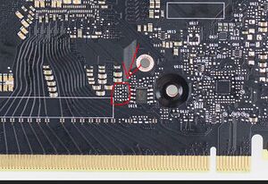

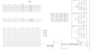

Straps
Configuration straps act like a switch to configure certain settings for the card. For example; memory type, memory capacity, enabling/disabling some functions etc.
Rarely, the strap resistors could become faulty and change in value or simply become an open line and prevent the card from working properly. Check their values outside of the circuit.
Location of the strap resistors on a reference RTX 2080. (Figure 2)
Schematic view of the straps and their functions. (Figure 3)

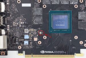

Crystal Oscillator
Often marked with Y followed by a number, crystal oscillators sometimes fail which will lead to the card not booting up.
Location of the crystal oscillator clock generator on a reference RTX 2080. (Figure 4)
In most if not all Turing GPUs, the frequency of the oscillator is 27MHz. An oscilloscope or a multimeter with Hz function that can go above 27MHZ is needed to test it.
