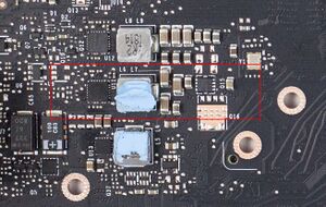

In Turing cards, you'll most likely find a GS9238 or similar buck converter that steps down 12V to 1.8V used to power low level logic inside the core and the bios chip(s)
1.8V rail location on the PCB (RTX 2080 Ref) (Figure 1)

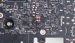

Input Voltage selection (Figure 2)

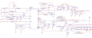

Schematic view of the 1.8V rail (Figure 3)

The controller steps down 12V on the input, either from the PCI-E slot or the external 8 pin connector(s) (based on which of 2 resistors is populated, see figure 2) to 1.8V on the output.
The FB pin is used to set the output of the controller through a resistor divider between it and Vout . In this case, for 1.8V out, a 10K/5K divider is used (see figure 3).
Enabling this controller is a signal coming from the and-gate (shown in figure 4) whose inputs are the PGOOD signal coming from the 5V Rail on Turing GPUs and the output of 2 voltage detectors one for 3.3 and the other for 12V_Bus.
VCC comes from the 5V rail through a resistor.

First thing to check is the EN signal which should be 2+ V followed by Vin which should be 12 V (Figure 3) if one of them is missing then check the schematic and follow the signal to find the culprit, it's usually a faulty resistor.
After making sure both of the above are there, check the VCC pin. If there is no 5 V on it then it's possible that the resistor between the 5V supply and the controller is blown open (controller could be short if the resistor is blown!)

PGOOD signal is pulled high through an external resistor. If the output voltage is normal but there is no PGOOD then you need to check that resistor (Figure 3). If the resistor is fine but the signal is held low by the controller then the controller could be faulty.
Low voltage on 1.8V rail
This usually only happens with a faulty controller or faulty resistors in the FB circuit. First check if the resistor divider resistors are fine. If yes, then the controller is faulty.
