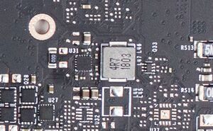

Turing cards usually uses MP28167 or similar to step down 12V to 5V that is used to power different ICs found on Turing cards.
On lower end cards, 5V is created by a 3 legged LDO.
5V Rail location on the board (RTX 2080 Ref) (Figure 1)

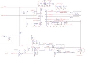

Schematic view of the 5V circuit. (Figure 2)
Markings on the board and schematic may differ from one GPU vendor to another, however, the circuit is almost always the same.

First thing to check is the EN signal which should be 2+ V followed by Vin which should be 12 V (Figure 2) if one of them is missing then check the schematic and follow the signal to find the culprit, it's usually a faulty resistor.
After making sure both of the above are there, check the VCC pin. If there is no 5 V on it then most likely the controller is faulty and needs changing.
