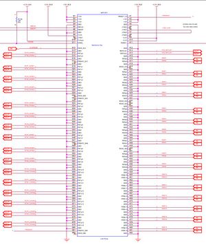

PCIe slot pinout (Figure 1)

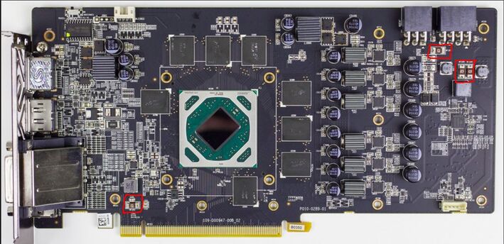

RX 590 Nitro+ PCB (Figure 3) From of TechPowerUp
From Figure 1, you can see the card gets its 12V_Bus from first 3 pins from the front and 2nd and 3rd pin from the back, they're all connected together and usually pass through a 0Ohm resistor that acts as a fuse or in some cards an actual fuse before going through the card (Figure 3).
In case of a short, those fuses are the first to go out to protect the card. Sometimes they can malfunction and either have a high resistance where the 12v drops to a lower voltage or simply blow and become open.
Make sure to check both ends of the fuse for a short to ground before replacing, it's usually rare that they blow up for no reason.
The fuses are usually the 10-15Amp variety.

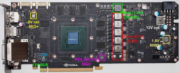

GTX 1080 Ref PCB (Figure 4) From TechPowerUp
The 3.3V rail comes only from the PCIe connector, 8th pin from the front, and 9-10th pins from the back. 3.3V is used as the enable voltage for some ICs and as Voltage In for others e.g. the bios chip. The card does not pull a lot of current through this rail so it does not usually come with a fuse, shunt resistor or a coil but sometimes it does as shown in Figure 4.
