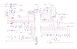

The controller circuit

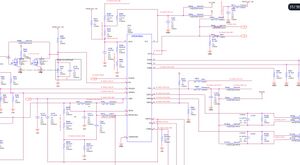

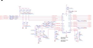

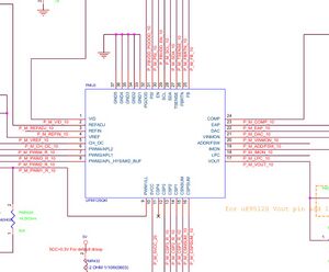

on Turing GPUs, the PWM controller responsible for regulating VMem voltage can differ a lot from different board makers but the most common ones used are UP9512P or UP9512S or UP9529 (no public datasheet for them but pinout is available in the schematics below) or UP1666Q.
The controller usually gets its power from 5V rail through a low resistance (0-10Ω) resistor

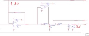

Enabling this controller is the 1.8V rail through 0Ω resistors then to a logic AND gate as one of the inputs and the other input is the output from an AND gate whose inputs are the EN and PGOOD of the VCore controller.
PGOOD from this controller is not used for anything.

Check if the controller has 5/3.3V on its VCC, and around 3 V on EN. If one of them is missing trace their respective circuits and check for broken, knocked off, or defective components
If EN and VCC are present and still no output, check the VREF pin, it should be 2 V. If not, the controller itself might be the culprit.
