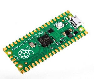

Raspberry Pi Pico
Required tools
In order to connect to the Xbox you will need a Raspberry Pi Pico.
You will also need some wires.
You need a Soldering Iron.
Preparing the Raspberry Pi
The first step is to flash a custom firmware on the Raspberry Pi.
The best option to do this is to follow the oficial guide on Github [1]

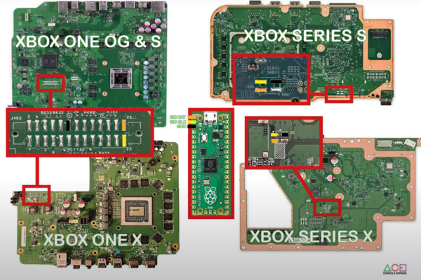

Connecting the USB-TTL to the console
After flashing the firmware on the Raspberry Pi we are ready to solder 3 points from the motherboard to the raspberry.
Follow the image below the image below.
Xbox I2C Connection points

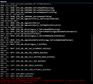

In order to pull the errors from the console we will need a program to communicate with the console, in this guide we will use XboxPostcodeMonitor [2]
Download and install the software above.
Connect your Raspberry device to the computer, plug in the power supply of to the console and plug it in but dont turn the console on.
Next open the program and select the COM port where your Raspberry is connected to.
Next select your xbox model the click on "Connect"
After that turn the console on
You should get an output like this:
Xbox Error Example Output
