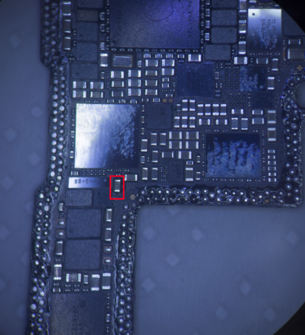

The problem generally is due to a faulty capacitor that is placed on the touch boost line. Replacing the capacitor C9201 fixes the issue.
Bad Cap
The bad capacitor

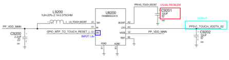

  2. Check for voltage on the PP_5V1_TOUCH_VDDTX_S2:
    • You cannot normally check voltage on this line
    • In order to check voltage on this line you have to manually enable the ic by giving it an enable signal and here is how to do it:
      Schematic

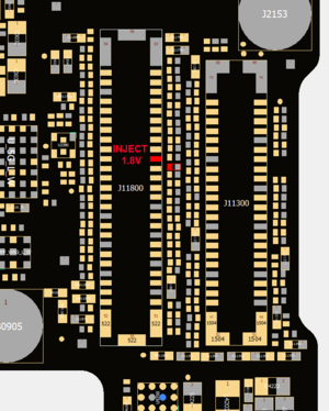

      • Plug the DCPS cable/ battery to the phone 3.8-4.2 volts
      • Inject 1.8v at lowest possible Ampere on pin #31(according to JC DRAWING) to enable the LDO output
        Inject Voltage

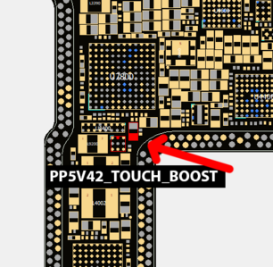

      • Check the output voltage on pin #44(according to JC DRAWING)
        Touch Boost Output
      • If you get no voltage output then proceed to the repair steps

  1. Split the board in half
  2. Check the capacitor C9201, if shorted it MUST be replaced.
NOTE: (if you don't replace this capacitor phone will still have no touch problem)
Bad Cap
