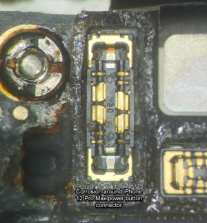

- Water damage or corrosion around the power button connector on the motherboard

First, you want to check the power button connector for liquid damage. Signs of corrosion will be your first clue. Clean all that off with isopropyl alcohol & a toothbrush.

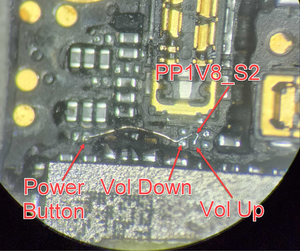

Repair Steps
You basically have 2 options. Easy option or difficult option. The easy option should be considered only for Data Recovery.
- Easy - Run a jumper from PP1V8_S2 to the lines stuck on a LOW state. So if you measured IO_BUTTON_SIDE_L_1V8_CONN was stuck on 0.6V (instead of 1.8V), you can feed it the 1.8V it is expecting. Same for the volume button lines. (see example image below)
iPhone12PM Jumper Solution for Stuck In Recovery Mode. PP1V8_S2 is feeding the 1.8V into the lines stuck on LOW. So the phone will stop being stuck in recovery mode. - Hard - Replace PMIC, which requires splitting the 2 layer motherboard sandwich.
