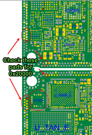

  • 2 Layer Sandwich - Requires the bottom layer of the 2 layer motherboard. If the Gyro U7300 is not detected, it will restart. It could have ripped pads on the top board for the Gyro lines.

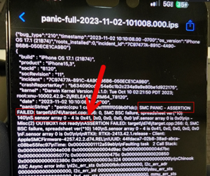

Before you start blindly replacing parts, it's important to try to confirm what is causing the restarting issue by reviewing the Panic Log file. This is a file that is generated by the Operating System, to document the fault causing the restart.
An example of panic log files you'll find in the iPhone when it has been randomly restarting.
To find the panic log on the device, go to Settings-> Privacy-> Analytics & Improvements-> Analytics Data-> Scroll down to the files starting with "panic-full..." & click on the most recent dated file.
Then you'll want to scan through the text for keywords that may point you to the cause.

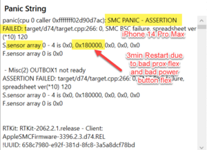

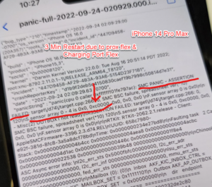

For this model, look for where it says "SMC PANIC - ASSERTION FAILED" ... "Sensor Array" .. "0x...."

  • 0xc0000 (or 786432) - It's the Prox Flex and Charging Port Flex
    • Make sure both flex cables are plugged in
    • Check that no flex is torn, liquid damaged, defective
    • Test with OEM or Premium. Aftermarket Flexes have a high defect rate
    • Diode mode the FPC connectors for any faults
  • 0x180000 (or 1572864) - It's the Prox Flex and Power Button Flex

    • iPhone 14 Pro Max will restart when the Gyro is not detected on the top board, giving 0x20000 panic log
  • 0x20000 (or 131072) - It's a sandwich board issue.
    • This means the sandwich board has separated. It could require a sandwich reball or a bottom board swap.
    • Check Gyro U7300
    • Check the pads for the Gyro U7300: 542, 543, 544, 545, 546, 6, 248
  • 0xa0000 (or 655360) - It's a sandwich issue and Proximity Flex Cable
    • Check the prox flex & FPC are good. Reference the above 0x80000 solution above
    • Check the sandwich pads related to the Gyro U7300. Reference the 0x20000 solution above

Example of what you'll see in a panic-full file, where when there's a bad prox flex and bad charging port flex causing the 3 min restart.

Example of what you'll see in a panic-full file, where when there's a bad prox flex and bad power button flex causing the 3 min restart.
