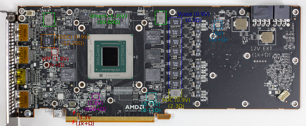

The Card Layout
RX 5700 XT reference board front view (Figure 1)
PCB Image by TechPowerUp
Before proceeding, it's advisable to inspect the card for physical damage, especially in the case of cards without a backplate. They can easily lose some components on the back due to poor handling.
Once you've confirmed there is no physical damage to the card, you can proceed with a multimeter to check the resistances of the voltage rails.

The card receives 12V power via the PCIe slot and additional 6-8 pin connector(s).
Begin by measuring the resistances of the 12V rail originating from the PCIe slot (first 3 pins or the inductor, see Figure 1).
Subsequently, measure each inductor for external power connectors (in case of multiple external power connectors, measure each inductor individually). Some cards use fuses on the input rails, measure both sides for continuity and then against GND.
The resistance value may vary from card to card, but it should generally be in the thousands+ Ω range. If you measure 50Ω or less (The computer may not turn on because the power supply activates overcurrent protection (OCP)) or you have a blown fuse, this means that you likely have a short on the card. Check: 12V Rail Short on Navi GPUs.
3.3V Rail
The card derives 3.3V power solely from the PCIe slot. It is obtained from the 4th pin going left from the PCIe key notch in the front and the 2nd and 3rd pins on the back going from the notch again (as depicted in Figure 1)
If you measure less than 50Ω on one or multiple base rails, you likely have a card with a short (OCP trigger, same as 12V short). Check: 3.3V Rail Short on Navi GPUs.

Step 2: Minor Voltage Rails (5V, 1.8V, 0.75V, VCore/SOC, VPP, Vmem/VDDCI)
Minor voltage rails are generated by the card itself using the base rails, either through Linear Voltage Regulators or Step Down Buck Converters.
Check the resistance of the output of these rails and compare them with Figure 1. VCore has such low resistance that measuring its resistance may not be very useful. A more helpful approach is to measure its resistance against the 12V rails, not GND.
If you measure lower resistance on one or more of these rails, refer to their respective pages for more information.
Otherwise, you can continue with the guide.

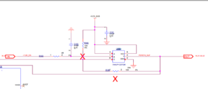

PERST_BUF Signal
PERST_BUF signal schematic view. (Figure 2)
U100 is a multiple function gate, the output of which is determined by the 3 inputs shown in figure 3. Since input A is always high (direct connection to 3.3V rail) according to the datasheet, the output will go high only if the other 2 inputs (B & C) are also high.
Sometimes this gate can fail which results in the output Y "PERSTb_BUF" signal not getting generated and prevent the card from working.
Start by checking all inputs, if one is missing trace it according to the schematic in figure 3 and replace the faulty components. If all the inputs are present but the output is low, check the Vcc pin and make sure the gate is powered (if not, maybe a cut trace), after that, replace it if all inputs and power is present on the gate.
If everything else is working as they should but still no video out then unfortunately you have a faulty GPU core. Best use for that card is as spare parts since getting hold of a GPU chip by itself is very hard and expensive and replacing it is a very advanced procedure that requires a BGA rework station and it's out of reach for many people.
