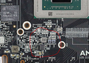

In Navi cards, you'll most likely find either a GS7260 (Full datasheet not available, used on non reference cards) or MPQ8633A buck converter (on reference cards) that steps down either 12V or 3.3V (Depending on the model) to 1.8V used to power low level logic inside the core and in some models the bios chip(s)
1.8V rail location on the PCB (RX 5700XT Ref) (Figure 1)

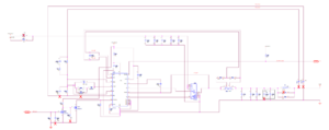

Schematic view of the 1.8V rail (Figure 2)

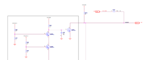

Enable signal for 1.8V rail controller (Figure 3)
The controller steps down 12V/3.3V on the input, from the PCI-E slot.
Enabling this controller is a detection circuit for 12V_BUS and 3.3V shown in figure 3.
VCC comes from 12V_BUS through a 1 Ohm resistor.

First thing to check is the EN signal which should be 3+ V followed by VCC /VIN (Figure 2). For the MPQ, VCC should be 3.3V and VIN should be 12V/3.3V. For the GS, VCC should be 12V. if one of them is missing then check the schematic and follow the signal to find the culprit, it's usually a faulty resistor.
After making sure both of the above are there, check the FB circuit, it is possible that one or more resistors are faulty.

PGOOD signal is pulled high through an external resistor to 3.3V. If the output voltage is normal but there is no PGOOD then you need to check that resistor (Figure 2). If the resistor is fine but the signal is held low by the controller then the controller could be faulty.
