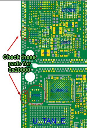

    • iPhone 14 Pro Max will restart when the Gyro is not detected on the top board, giving 0x20000 panic log
      Diode mode the FPC connectors for any faults
  • 0x20000 - It's a sandwich board issue.
    • This means the sandwich board has separated. It could require a sandwich reball or a bottom board swap.
    • Check Gyro U7300
    • Check the pads for the Gyro U7300: 542, 543, 544, 545, 546
