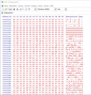

Figure 6: Controller firmware in HxD
Load the firmware into a hex editor like HxD (Figure 6)
At the beginning, there is the bootloader area (see boot_ra_Release.srec).
Between 0x00008000 and 0x00040000 sits the application data (see RA_APP_REL_6670771D.bin).
Between 0x08000000 and 0x08002000 there is provisioning and calibration data.
There is also some other data. I have not figured out what is what.
When you are done, either convert the file to the SREC format or flash the MCU with a bin file.
sudo ./rfp-cli -d RA -port /dev/serial/by-id/usb-Renesas_RA_USB_Boot-if00 00000000 data.bin
The command above should work. I have not tested this yet.
You can also write parts of the firmware to the MCU. Read the documentation.
Happy modding.
