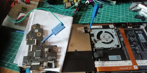

Figure 1: Connect the mode pin of the MCU to ground to switch to USB boot mode for programming

The RA4E1 MCU needs to be put into USB/Serial boot mode by pulling the mode pin (MD) to ground during reset/power-on and keeping it pulled down during programming.

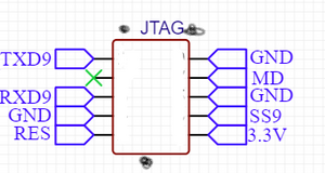

Figure 2: Pinout of the tag connect (TC2050) interface on the revision B controller board
Step 1 - prepare the controller board: Power off the Steam Deck/put it into standby. Connect the MD (mode) pin to ground (see figure 1). You can connect two pads of the tag-connect interface (the two on the upper right) for this (see figure 2). Power on the Deck/wake from standby. Check if the MCU has booted in USB mode by typing lsusb in console. You should see the following device (see figure 3):
