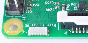

The Wi-Fi antenna has broken off the board.
- Pi 3 (B only)
Symptoms
- Wi-Fi antenna has broken off the board.
Solution
Replace with one of the following parts:
SLDA52-2R450G-S1
