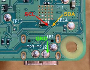

The following pads can be used to access the I2C interface:
Model | SDA | SCL |
Raspberry Pi 3 (A+ and B+) | PP60
PP59
Raspberry Pi 4 | The relevant traces |
