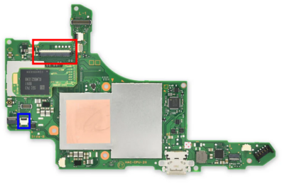

Figure 1. Front side of Nintendo Switch motherboard with the LCD connector circled in red and the backlight connector circled in blue
  • Switch will power on and make noise, respond to touch or button inputs but screen seems to not work

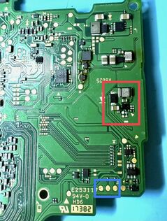

  • Figure 2. Back side of Nintendo switch motherboard showing locations of backlight circuit points of interest with the backlight IC circled in red and test points circled in blue
    First you will want to test with a known good LCD. You can dry fit a working LCD without removing the original by either just the bottom backlight cable or dry fitting both the LCD ribbon and backlight ribbon. See Figure 1 for reference on the locations of these connectors

  • First check the backlight connector for damage or loose pins

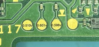

  • Figure 3. Backlight test points on the opposite side of where the backlight connector is on Nintendo Switch
    Next pull the board out and on the opposite of the backlight connector there will be test points as seen in Figure 3. Set your multimeter to diode mode and place the red probe on ground and use your black probe to test each of the test points labeled in Figure 3. If any of the readings are off by more than 0.200v that will confirm a problem with the backlight IC or one of the capacitors around the backlight IC.

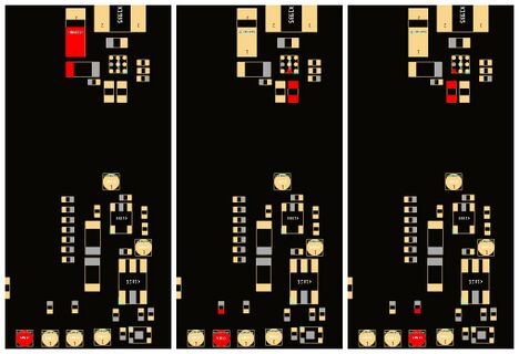

  • These 3 test points correspond to lines in the backlight circuit that are all needed for the backlight to function normally. See Figure 4 to see where each line goes. These points will also connect to 3 of the 4 pins on the backlight connector with the 4th being ground.
  • If the line you test bad is reading low or shorted then you will want to check for shorted components or corrosion around the components highlighted in Figure 4.
    Figure 4. Nintendo Switch backlight test points showing the components they connect to
  • If the line reads as OL or a very high reading then you likely have a broken trace or corroded pad under the backlight IC. If the leftmost test point is reading as OL or abnormal you could also have a bad diode.
  • It is common for corrosion from liquid damage shorting out or eroding the pads below the backlight IC so if you have abnormal readings and no shorted components around the backlight IC or you have removed/replaced the faulty components around the IC you may have to either try to reball it, or replace the IC
