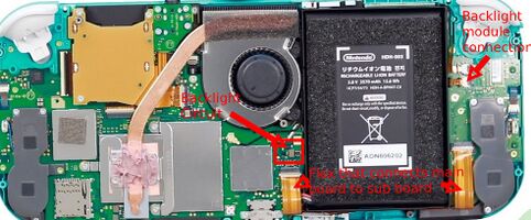

The first step is to always try new parts beforte assuming you have motherboard problem so start by testing a new display, Sub Board, Flex that connect the sub-baord to the motherboard.
If parts dont fix the issue the problem is with the backlight circuit.
Start by inspecting the Connector where the flex that comes from the sub-board to the main board for any liquid or physical damage.

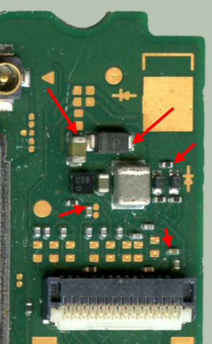

The first step is check for shorts in these points, put your multimeter in continuity mode and prove the points in the image bellow these points cant have continuty to ground, if they do there is a short circuit.

Nintendo Switch Backlight Voltages
If 3.6V and 1.8V are ok try and replace the Backlight controller.
