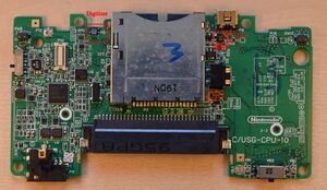

First, disassemble the device as far as needed to access the part you want to check. Please refer to Figure 1 for location reference.
Check the power button / slider
The power button is located on the bottom side of the PCB labelled SW13.

Check fuse F2
Fuse F2 is located near the power connector and the DS Game slot pins on the bottom side of the PCB. Check this fuse for continuity using your multimeter. If it is broken (measures as high resistance), continue with Replacing F1 / F2.

Check fuse F1
The fuse F1 is located right next to the power connector and EM10. Check this fuse for continuity using your multimeter. If it is broken (measures as high resistance), continue with Replacing F1 / F2

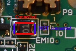

Check EM10
EM10 is located right next to the charging connector and F1. Check for continuity. The pins parallel to the charging port should be connected. See Figure 2. If there is no continuity between those pins, or if there is continuity to other pins, continue with Replacing EM10.

Replacing EM10
Desolder the filter EM10 and replace it with a new one. If none is available, or to test if this fixes the issue, you can bridge the pins that should appear as connected. Be aware that in doing so, your device will be more susceptible to instabilities with cheap, low quality power supplies.
