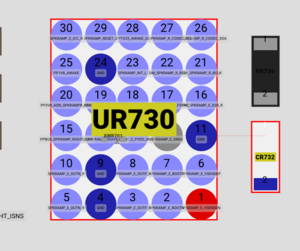

CR732 Boardview
I began by isolating all audio-related components from the board - both speakers and the headphone jack flex. Videos would still not play properly. The next step was to conduct a visual inspection of the board under the microscope. Suspect areas were around UR500 Audio Codec, and all four speaker amp ICs UR700, UR730, UR600, and UR630. Upon visual inspection, I noticed that there was a loose capacitor near UR730. I checked the boardview and schematics to determine that this was CR732 on the SPKRAMP_E_DREG line.
Repair Steps
I removed CR732, tinned the pads, and soldered it back onto the board using hot air and leaded solder. Audio played normally after reassembling.
