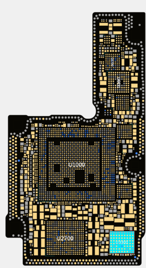

iPhone XS will turn on but does not charge
iPhone Xs Yangtze location on bottom side of top board

  2. In majority of cases, you'll find that replacing Yangtze (U3300) will solve charging problems
    • Yangtze will give the common "Tristar" issues that you would see on iPhone 7 and older models.
    • I would recommend you split the sandwich & test charging with just the top board, battery, charging port and screen.
      • If you get 0.006 A or something very low, try replacing Yangtze
