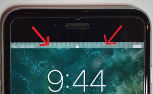

The iPhone turns on but touch doesn't work or its intermittent
iPhone 6 Plus Touch Disease!
Symptoms
  • Touch does not work
  • Touch is intermittent
  • Touch doesn't work and some weird lines show up in the top part of the screen when you flex the phone

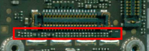

If this is your first time doing this repair I recommend that you remove the underfill from these components. Since we will work on the backside of them they may disconnect, if these components disconnect it may cause problems like the front camera not working, the earpiece not working.
Where to remove the underfill

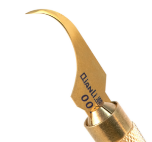

To remove this underfill it doesnt take much heat i recomend using your heatgun and a 007 blade like the image bellow.
007 Blade

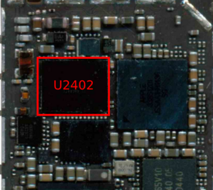

The touch ic is located on the back side of the motherboard near the WIFI IC.
U2402 Location
Use your heat gun to desolder the chip be careful to not use excessive heat since the CPU is on the other side and excessive heat may cause it to disconnect.
After removing the IC add some low-melt solder with your soldering iron to the pads on the motherboard to make it easier to clean.
Clean the solder from the pads on the motherboard.
After cleaning the pads, check for any ripped pads, you may have one missing that is common to break the "M1" pad.
