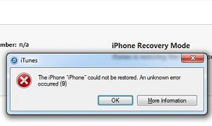

On the iPhone 6 Plus this error is usually a problem between the CPU and EEPROM (U0301)
iTunes error 9
Symptoms
  • The phone boots straight into recovery mode
  • iTunes produces the error 9 when restoring the device

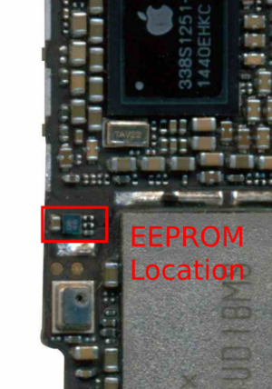

In order to verify that in fact the issue is between the CPU and EEPROM we must take diode readings on two resistors, these two components are located under a shield, in order to reveal them you must remove a tiny bit of metal in the position of the image below.
iPhone 6 Plus EEPROM location

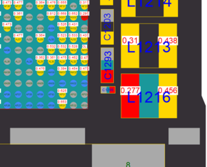

The next step is to measure the two resistors in diode mode, they both must have a value of around 0.484, on some devices both lines will read bad and on some devices only one is faulty.

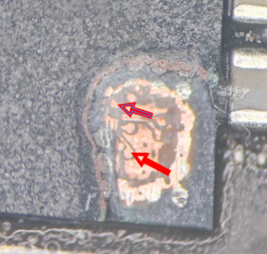

At some point you will arrive at some grey pads, this means that you're getting close, keep scraping really slowly.
iPhone 6 Plus RAM Pads
After you scrape a little bit you will start to see the line inside the CPU, the two lines that we are after are these ones.
iPhone 6 Plus CPU Lines

After soldering the wires check for a short on PP1V8_SDRAM you can do this on this cap.
