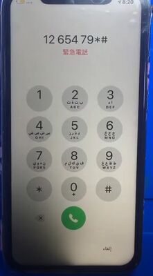

The device turns on and works but there is a dark spot on one of the bottom corners.
Example of issue iPhone 11 with a dark spot on the left corner

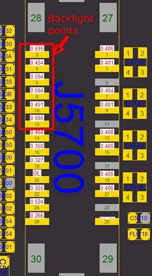

Start by taking diode readings of the LCD FPC especially the backlight lines and compare with the image below. If a line that should have 0.500 measures 0.000, you know there is a short. If it measures OL or nothing at all, it means that the circuit is open.
Image FPC Diode readings
After taking diode readings of the FPC, you will probably already find the line that is faulty, use a program like ZXW to trace where it goes.

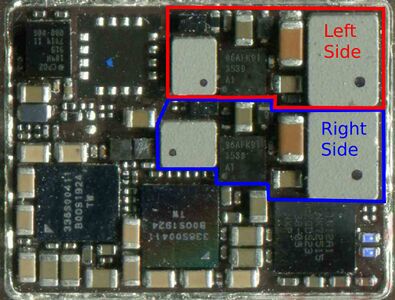

As we said before, there are 2 backlight circuits, so if you have a dark spot on the left side of the screen, you should focus your attention there.
iPhone 11 Backlight Circuits

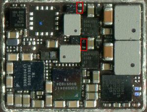

The most common issue is for the output resistor to be blown, if you already took diode measurements of the FPC you saw that.
iPhone 11 Backlight Circuit Output Resistors Location

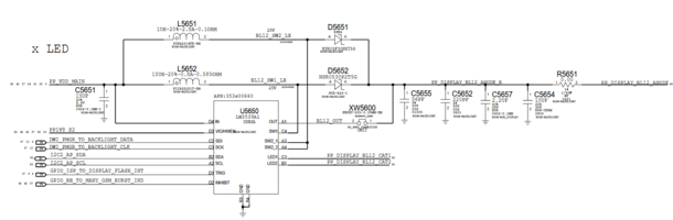

Here is also a schematic of how one IC works in detail.
iPhone 11 Backlight Circuit Schematic
