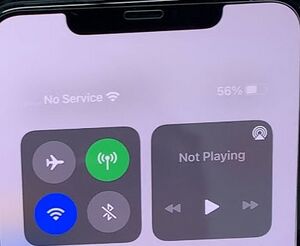

The iPhone is unable to get network service but IMEI is present when dialing *#06#.
iPhone 11 With no Service
Symptoms
  • The iPhone is unable to get network service but IMEI is present when dialing *#06#.
  • The Phone is always searching for network.

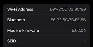

Example Modem firmware
Go to the Settings app, General > About, scroll down, and check if Modem Firmware is present.
When this information is present, it already tells us that the Baseband CPU and Power Management Unit (PMU) are working.

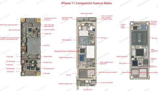

The next thing to check is to compare the diode readings of specific pads with a known good board, or if you have a program like ZXW, you can check the values there, but generally, you want to check the lines or pads close to the network-related chips.
The Network circuit is devided into both motherboards the top board and bottom board.
iPhone 11 Component Location
After taking diode readings of the bottom board, shift focus to the top board. This is probably where the issue is.
Below are the diode readings around the network chips on the top board of the iPhone 11 series. It is common for the VFE_HI_3V15 line to get shorted.
In order to locate the short on the VFE_HI_3V15, you must inject 1V into the line and monitor the temperature using a thermal camera of the capacitors and two ICs.
