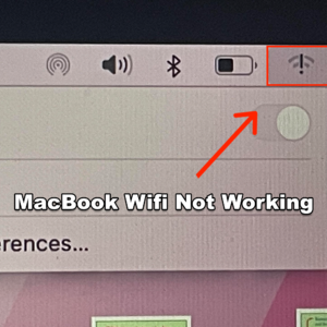

On MacBook models with M-series chipset (M1/M2/M3/M4), Wi-Fi can stop working due to a failed Wi-Fi IC. Even after macOS reinstall, the machine may show “Exclamation Mark on Wifi Toggle” because the Wi-Fi IC is paired to the logic board via ECID binding. Replacing the IC requires unbinding and rebinding the Wi-Fi chip to the MacBook.
Symptoms
  • Wi-Fi greyed out in macOS.
  • "Exclamation mark" on WiFi
  • Bluetooth may also fail in some cases.
  • macOS reinstall, PRAM/SMC reset do not fix the issue.
    WiFi Not Working (Figure 1)

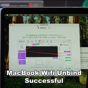

  1. Install Luban software (LB-WIFI-OFF) using a pendrive.
  2. Launch Luban software with internet connection (mobile hotspot works).
  3. The software will unbind Wi-Fi and read the MacBook ECID automatically.
    Successful WiFi Unbind

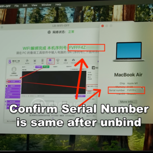

  4. Verify in “About This Mac” that serial number is correct.
    Verify Serial No. is same after unbind.

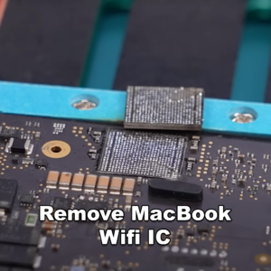

6. Disconnect battery, remove logic board from chassis.
7. Remove Wi-Fi IC with hot air.
Remove MacBook WiFi IC
8. Clean solder pads using wick + flux until smooth.

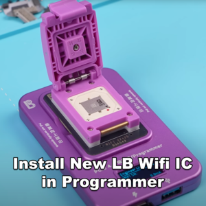

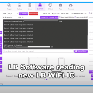

Programming the Wi-Fi IC
9. Connect Luban programmer with Wi-Fi IC reading module.
10. Place Wi-Fi IC in the module.
WiFi IC in LB Tool

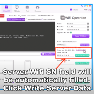

11. Open Luban tool → wait for IC to be read.
New LB WiFi IC reading

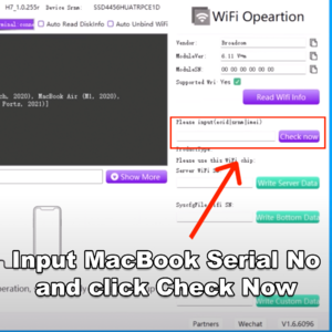

12. Input the MacBook serial number (recorded earlier).
13. Click Check Now.
Input Serial Number
14. After verifying, Click Write Server Data.
Write Server Data

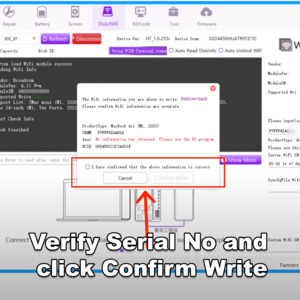

15. Verify if written info (Serial) is correct.
16. Confirm write.
Verify Serial Number
17. Wait for successful confirmation.

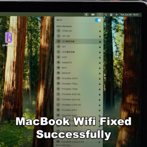

Verification
  • Boot into macOS.
  • Wi-Fi should now be detected and toggle enabled.
  • System Information should show Wi-Fi hardware with correct addresses.
  • Connect to a Wi-Fi network and run stress test (download/upload).
    WiFi fixed successfully.
