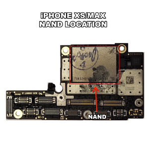

1. Remove NAND
- Separate upper board from RF board.
- Remove NAND.

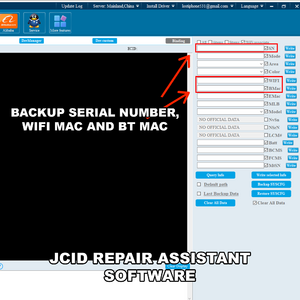

2. Read NAND

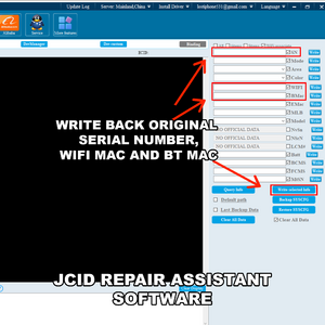

Use JC BGA110 adapter:
- Perform full read.
- Extract device-specific fields (Serial Number, BT Mac & WiFi Mac Address).

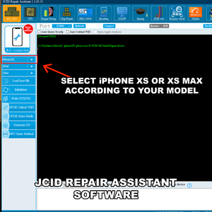

3. Prepare Clean Image
Inside programmer software:
- Select "iPhone XS or XS MAX" as per your device.
- Paste original essential data (SN, WiFi/Bluetooth MAC).
- Do NOT change storage capacity.

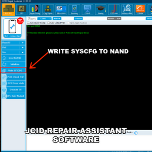

4. Write NAND
- Write generated clean configuration.
- Verify write success.
5. Reball NAND
- Reball original IC (or replace with same capacity).
- Clean pads, apply flux, align properly.
6. Solder NAND Back
- Same careful angle as removal.
- Avoid overheating CPU.
