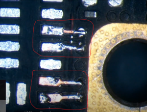

How to fix iPhone 8 Plus with grayed out wifi. This is most common on iPhone 8 Plus, not so much on iPhone 8, but still possible.
Example of 4 jumpers needed for WiFi repair on iPhone 8 Plus
Figure 1. Example of 4 jumpers needed for WiFi repair on iPhone 8 Plus

  • WiFI button is not clickable in the control panel This means there is a board issue. It is not an antenna or flex issue, as they don't cause the button itself to be grayed out.
Solution
  • In most cases, there are ripped pads on the corner, under the WiFi (WLAN_W) chip. See Figure 1
  • Pins 19, 20, 22 and 23 must be jumped to their respective traces.
  • For Example: iPhone 8 Plus - 4 Jumper solution for Grayed Out WiFi
  • Once the jumpers are in place, use UV mask to cover them, to prevent any shorting/bridging/movement
  • Reball the original WiFi IC & place back.
See full repair tutorial here: https://youtu.be/eVmKNJ7nsgI
If the WiFi chip ends up having torn pads, you must replace the WiFi IC.
