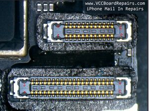

  • Diode mode the LCD connector (J4502) and check for any lines that are OL or 0.000V (shorted).
  • In most cases, you'll find pry damage near the connector, causing damage to a filter or resistor. Commonly damaged:

Another solution:
  • If you found the diode mode readings are all normal, then most likely it's a connector issue
  • Find the 4 ground pins on the LCD and Home Button connectors and use fine tip tweezers or an Xacto blade to bend them outwards.
  • Refer to the example image
  • How To Fix No Touch on iPhone 7
  • Usually this issue is caused from too many screens being unplugged and plugged in, causing those pins to be pushed outwards
  • Or from someone plugging in a 8/8P screen into a 7/7P board.
  • If still no touch, you can try replacing the LCD connector to see if that solves it.
