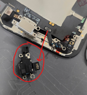

  • Charging Port Flex - This is the flex towards the bottom of the phone. It is easily damaged with a drop & the back glass is breaks. Or when someone has repaired the back glass.
  • Air Pressure Sensor - This part is located at the bottom of the housing & connects to the charging port flex. If it gets physically damaged or water damaged, it can cause 3 min restarts

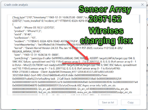

  • Wireless Charging Flex - The flex that's attached to the back glass. It must be plugged in & not damaged, otherwise it will restart every 3 minutes

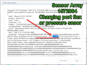

  • iPhone 16 1572864 Panic Log Example
    iPhone 16 1572864 Panic Log Example for Charging Port or Air Pressure Sensor fault

  • iPhone 16 Panic Log Example for Back Glass fault

For this model, look for where it says "SMC PANIC - ASSERT" ... "Sensor Array" ..
If you see:
  • 1572864 or 524288 - It's related to the Charging Port Flex
    • Make sure this flex is plugged in
    • iPhone 16 Air Pressure Sensor. If not connected or damaged, it will cause panic log 1572864
      Check the bottom mic/air pressure sensor module is connected
    • Check that no flex is torn, liquid damaged, defective
    • Test with OEM or Premium parts.
      • Aftermarket Flexes have a high defect rate

  • 2097152 - It's related to the Wireless Charging Flex
    • Test with OEM or Premium. Aftermarket Flexes have a high defect rate
    • Diode mode the FPC connectors for any fault

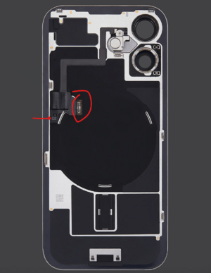

iPhone 16 Back Glass - If you don't have this flex plugged in, it will cause 3 min restarts with panic log 2097152. The important part of the flex is the small IC where the red arrow is
