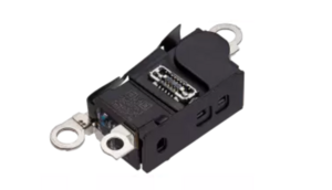

There are many reasons that could cause an iPhone 16 Pro and iPhone 16 Pro Max to randomly restart every few minutes.
For the iPhone 16 Pro series, there are some sensors within the parts of the phone that are required to be plugged in & detected. Otherwise, the phone restarts on its own.
The most common for iPhone 16 Pro series are:
  • Charging Port Flex - This is the flex towards the bottom of the phone. It is easily damaged with a drop & the back glass is breaks. Or when someone has repaired the back glass.
  • Bad Battery - If the battery is defective or goes bad, it can cause restarting problems.

Before you start blindly replacing parts, it's important to try to confirm what is causing the restarting issue by reviewing the Panic Log file. This is a file that is generated by the Operating System, to document the fault causing the restart.
To find the panic log on the device, go to Settings-> Privacy-> Analytics & Improvements-> Analytics Data-> Scroll down to the files starting with "panic-full..." & click on the most recent dated file.
Then you'll want to scan through the text for keywords that may point you to the cause.
For this model, look for where it says "SMC PANIC - ASSERTION FAILED" ... "Sensor Array" ..
If you see:
  • 3145728 and 2097152 (0x300000 and 0x200000 when translated to HEX) - It's related to the Charging Port Flex
    • Make sure this flex is plugged in
    • iPhone 16 Pro Max Air Pressure Sensor. If not connected or damaged, it will cause panic log 3145728
      Check the bottom mic/air pressure sensor module is connected
    • Check that no flex is torn, liquid damaged, defective
    • Test with OEM or Premium parts.

      iPhone 16 Pro Max - Charging Port Flex is Bad. Sensor Array 3145728
