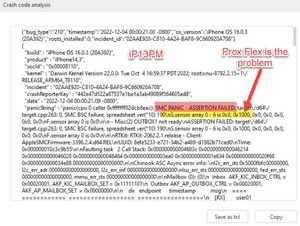

Before you start blindly replacing parts, it's important to try to confirm what is causing the restarting issue by reviewing the Panic Log file. This is a file that is generated by the Operating System, to document the fault causing the restart.
To find the panic log on the device, go to Settings-> Privacy-> Analytics & Improvements-> Analytics Data-> Scroll down to the files starting with "panic-full..." & click on the most recent dated file.
Then you'll want to scan through the text for keywords that may point you to the cause.
For this model, look for where it says "SMC PANIC - ASSERTION FAILED" ... "Sensor Array" .. "0x...."
If you see:
- 0x1000 - it's the proximity flex cable
- Make sure this flex is plugged in
- Check that no flex is torn, liquid damaged, defective
- Test with OEM or Premium. Aftermarket Flexes have a high defect rate
- Diode mode the FPC connectors for any faults
